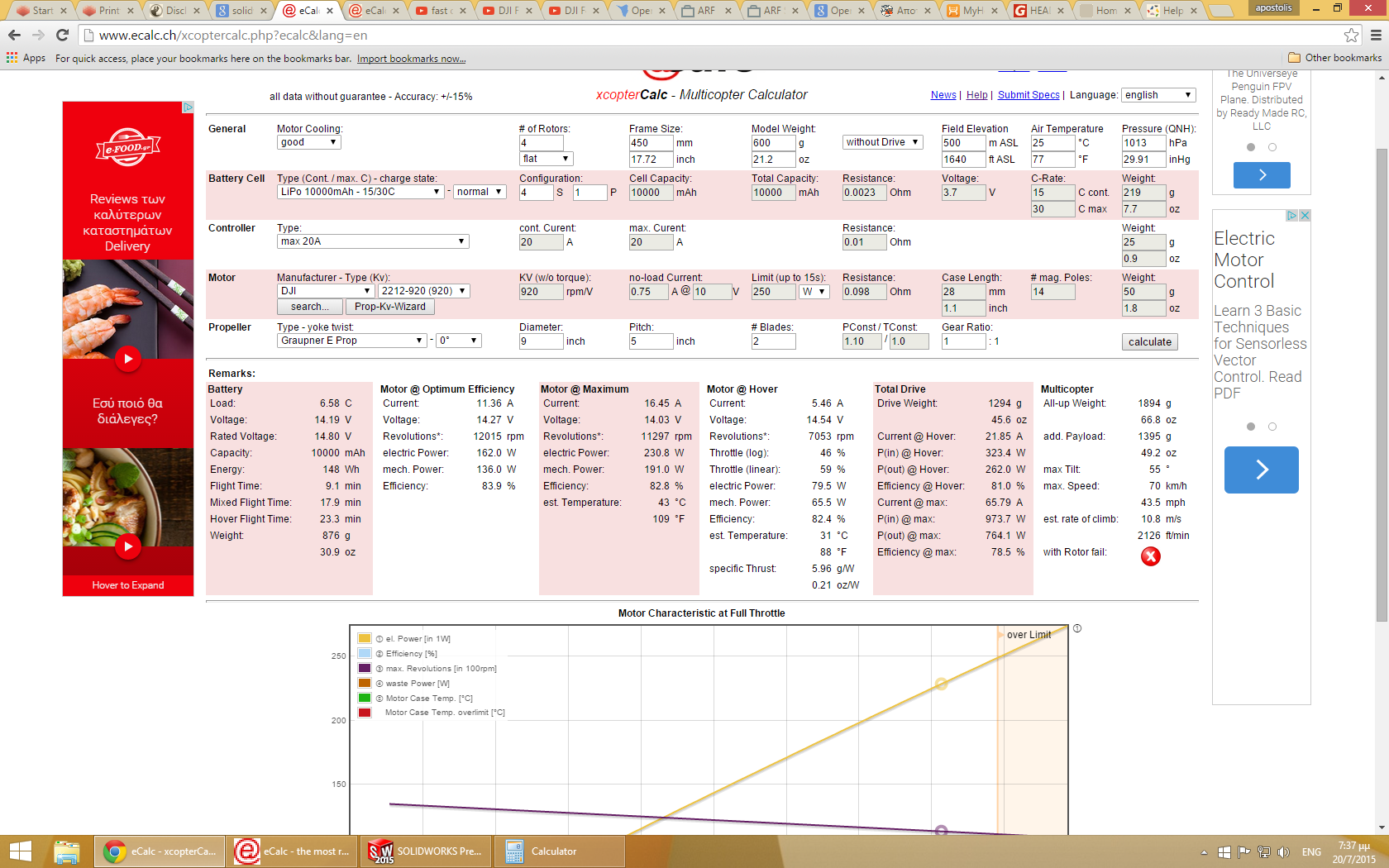

the battery i plan to use weighs 800g and it is 10000mAh 4S1P… I tested my combination using ecalc.ch tool, and in the attached image you can see the results… According, to ecalc it seems that there is no problem… I mean the speed is quite fast, and the flight times good…
I wouldnt like to use smaller battery because that would drop my flight times… Is there something else I could do, to keep the flight times and quadcopter speed as you see it in the attached image??

If thats what it says on Ecalc maybe I am gettting wrong thrust values on your motors (we dont sell them so I am not sure about actual thrust values) But if you have the thrust specs please post them so I can check.
However one thing I did notice on your screenshot is that its saying the battey weight is 219g, so it might be worth going over everything again to double check.
Let me find the thrust values now and i will post them now immediately…
Regarding battery weight, the weight you see is the weight of one cell… If you multiply it by 4 it gives 876g…and it is also shown in the bottom under the remarks section for the batery… However, as i told you the battery i found weighs 800g…
