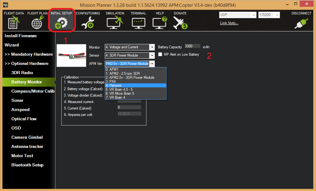

Check your setting in mission planner to make sure your failsafe has been set correctly as you can set it to enter battery failsafe based on voltage, or voltage and capacity, also make sure that the battery voltage and capacity are set correctly on your autopilot via mission planner, as sometimes the power module could be out slightly. If you need help on how to calibrate your power module just let me know.

However within mission planner is it now reporting the correct voltage, and have you set the battery failsafe correct?
