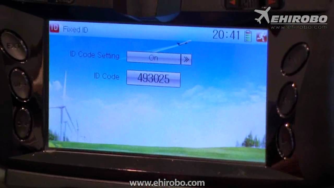

2.4Ghz receiver binding is not permanent. It will just mean that you pair a receiver to a specific transmitter (methods vary depending on manufacturer) but with all of them its not permanent ( it will only save the binding until you erase it), so you can pair a receiver to another transmitter at another stage.
Here is a video binding a receiver to a Devo transmitter
