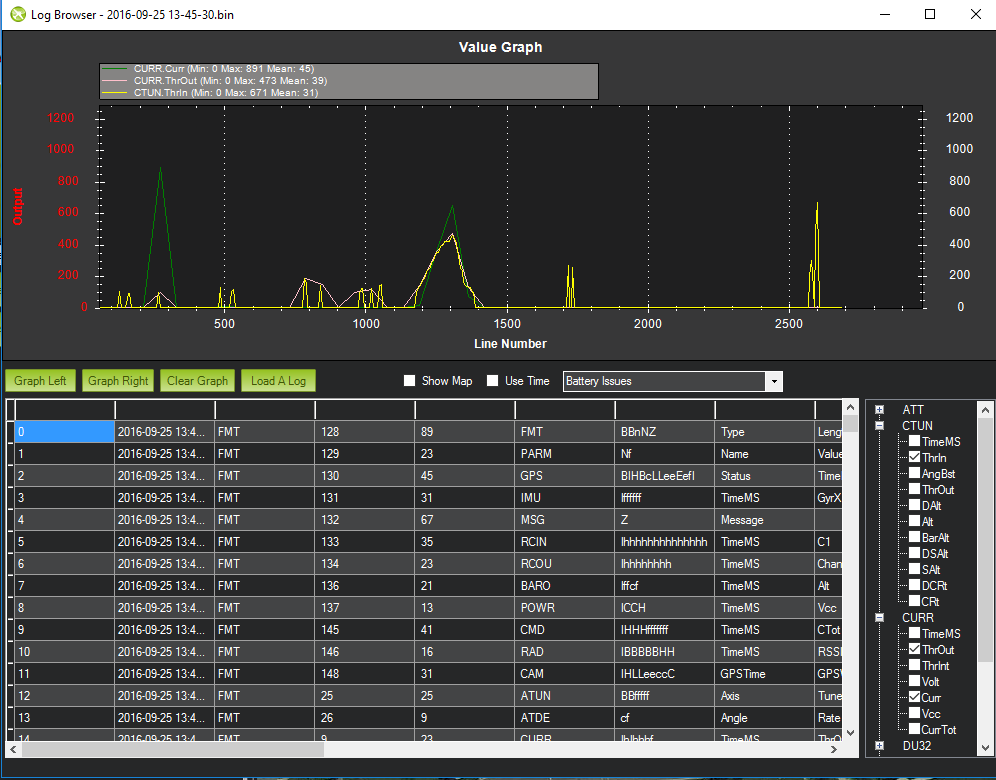

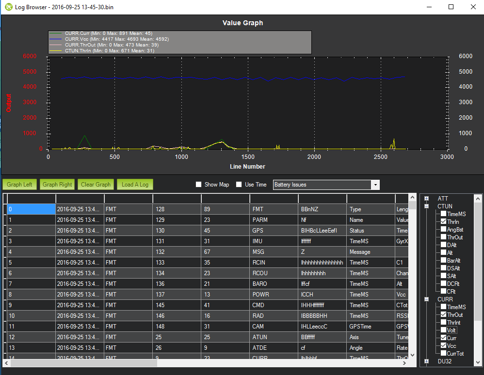

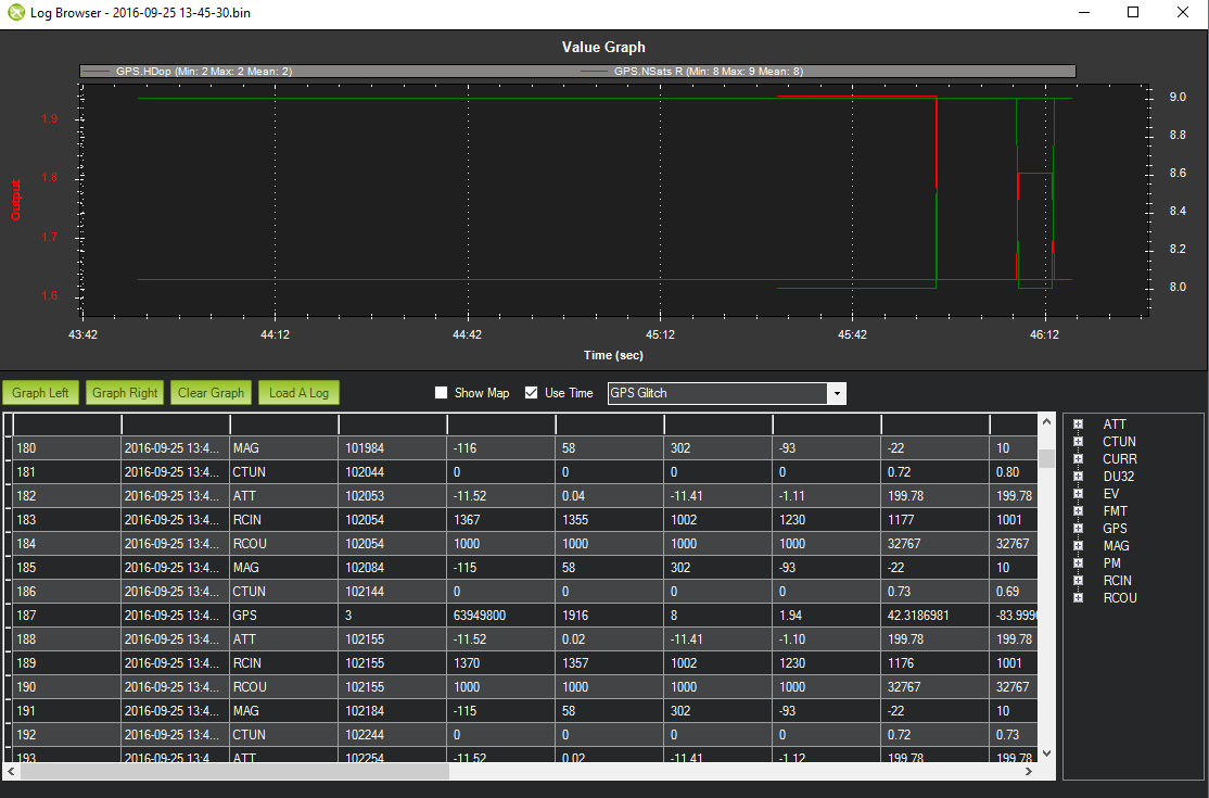

You should look at is to graph ThrOut vs Vcc to make sure you are not having any power issues on your arducopter. You can also try look at GPS HDOP values/sat count vs failsafe triggers in the logs to see why it is triggering.

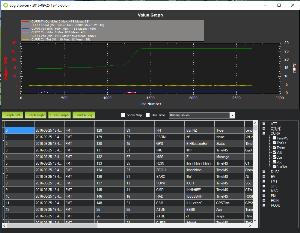

Thanks! I’ve noticed the problem happening in manual flight mode but I think it happens in any other flight modes too. When I connect the APM to my PC it almost instantly gets 9 satellites with HDOP around 1.9, so I don’t think that’s the problem but then again maybe I’m not waiting long enough after turning my APM on before taking off. How can I graph ThrOut vs Vcc like you said? And also, how do I look at log files without auto-analyzation? I could send you one of the .log or .bin files if you want.
Nevermind, figured out how to do it. Here are the graphs. Anything look fishy?

If the graphs look ok, why do you think it’s having the problem? Do I need to do the (dreaded) factory reset?
