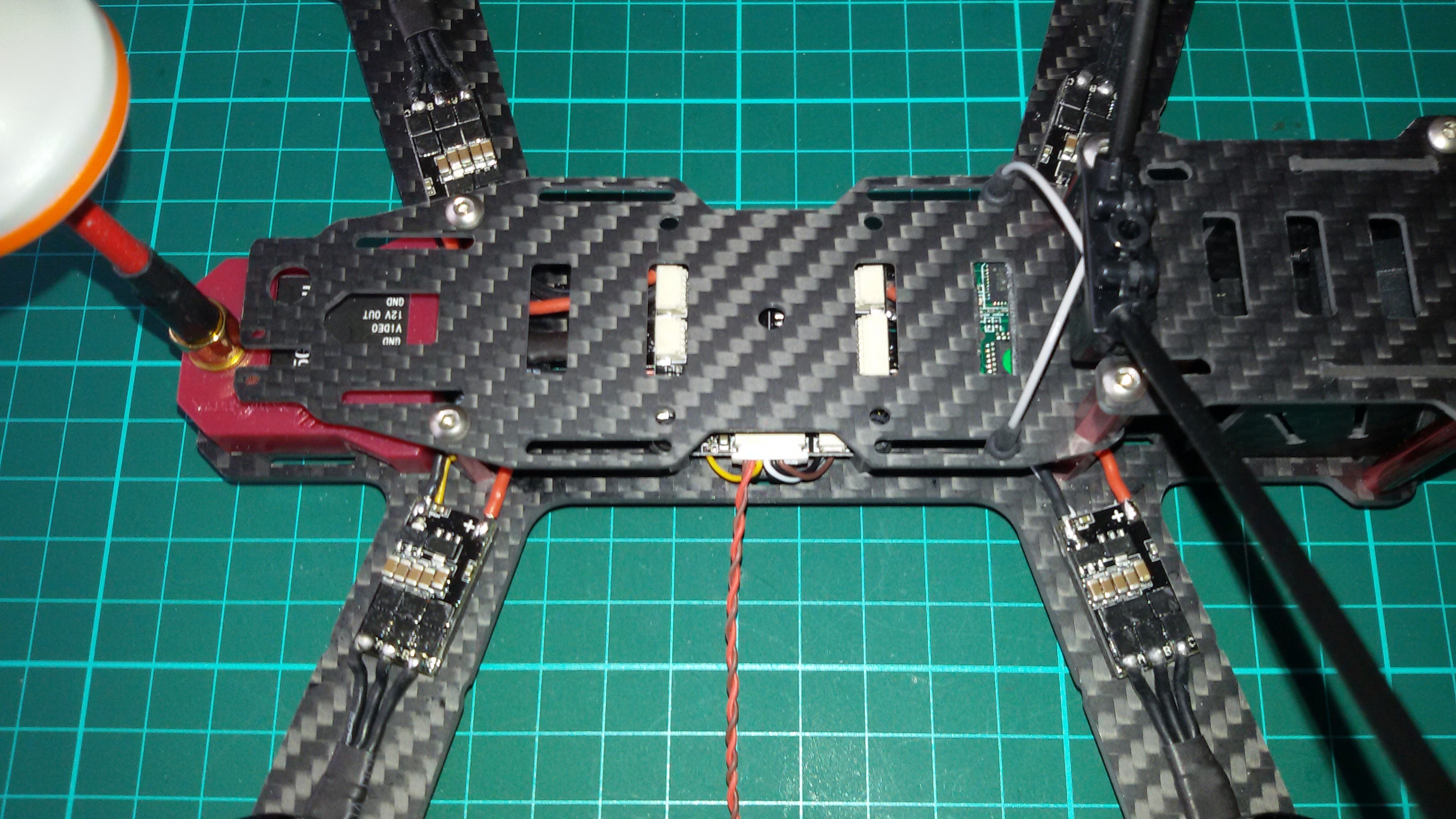

and there’s no indication on the ESCs themselves…
Also, the ESCs that come with the kit have no shrink wrap (unlike the 20A Nano ESCs that we sell from Emax separately) and so there’s no way to tell if they’re 20A ESCs… or is there?
The Confirmation
I can confirm that the Nighthawk 200 kits do come with 20A Nano ESCs (with no shrink wrap) and you can check this by simply studying the MOSFET number that you can find on the ESC. This should be 7418.
