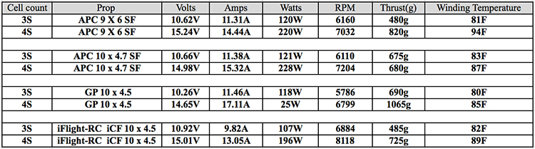

1 - with the 850Kv motors and 10 inch props the motors will be able to produce about 2.8Kg thrust. Given that you want to hover at about 50% thrust the total weight of your arducopter should not weight much more than 1.6Kg. I cant recall of hand what the weight of the quad frame is , but in general if you just need to add another 100g then the basic setup will be fine :-). To learn more check out our guide on what motor you need for your drone.
Here are the motor test data table for the arducopter 850Kv motors should you be interested:
