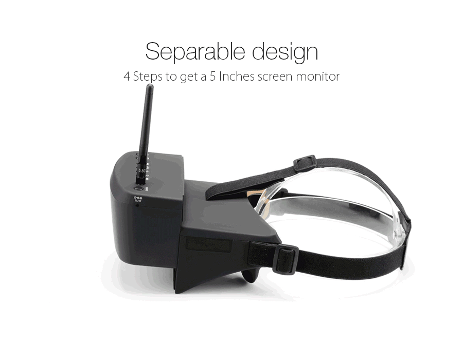

If you cant decide, get the EV800 set, they give you the best of both worlds, as you can wear them as a headset, or remove the headcover/lens and use it as a monitor
You can buy from us if you are in the UK/EU - https://www.unmannedtechshop.co.uk/ev800-fpv-moggles-monitor-and-goggles/
PS: contact me if you want the new version that now includes a DVR, as we just received them a few days ago
