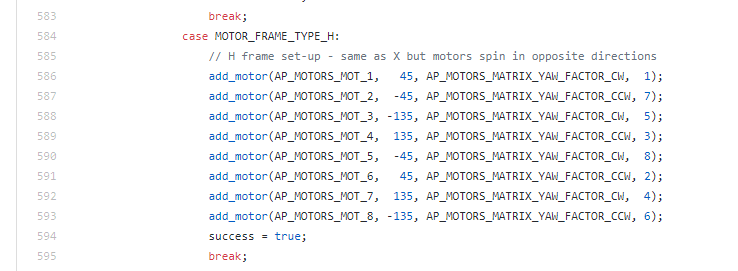

Thanks for the reply. I m not so familiar with the background of firmware but had a check. The set up codes (for the motor config file) are exactly the same for X and H in both quad and octo and configurable in PX4, too. At this moment, another point comes to the scene. Why do both setups seen on the frame configuration screen (i mean Quad H and Quad X)? This is a kind of prevent against mind confusing? And they are giving seperate choices to make it clear. Or they have something different on the firmware side?
