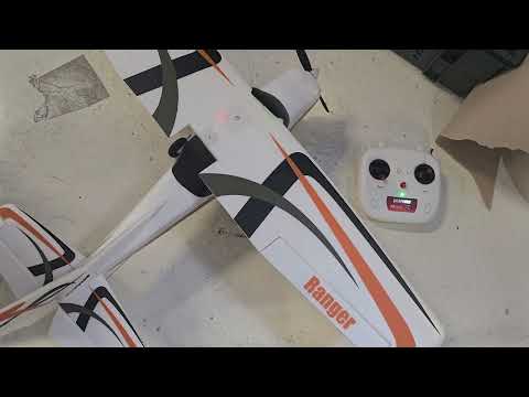

FMS Ranger Trainer 850mm Startup Issue (Throttle Not Working)
Just a quick share to show the bootup procedure of the FMS ranger, as it can take around 20-30 seconds for the accelerometers and gyros to calibrate before it will arm the motors/elevator. Just incase someone else has this issue and cant find any info about it on the internet:
