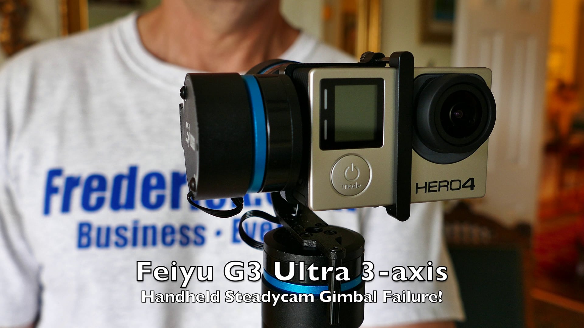

Several people have had this one problem with the FY-G3 handheld gimbal of an annoying leaning of the camera to one side after a few minutes of power. This video shows one of the worst cases:
What can be done?

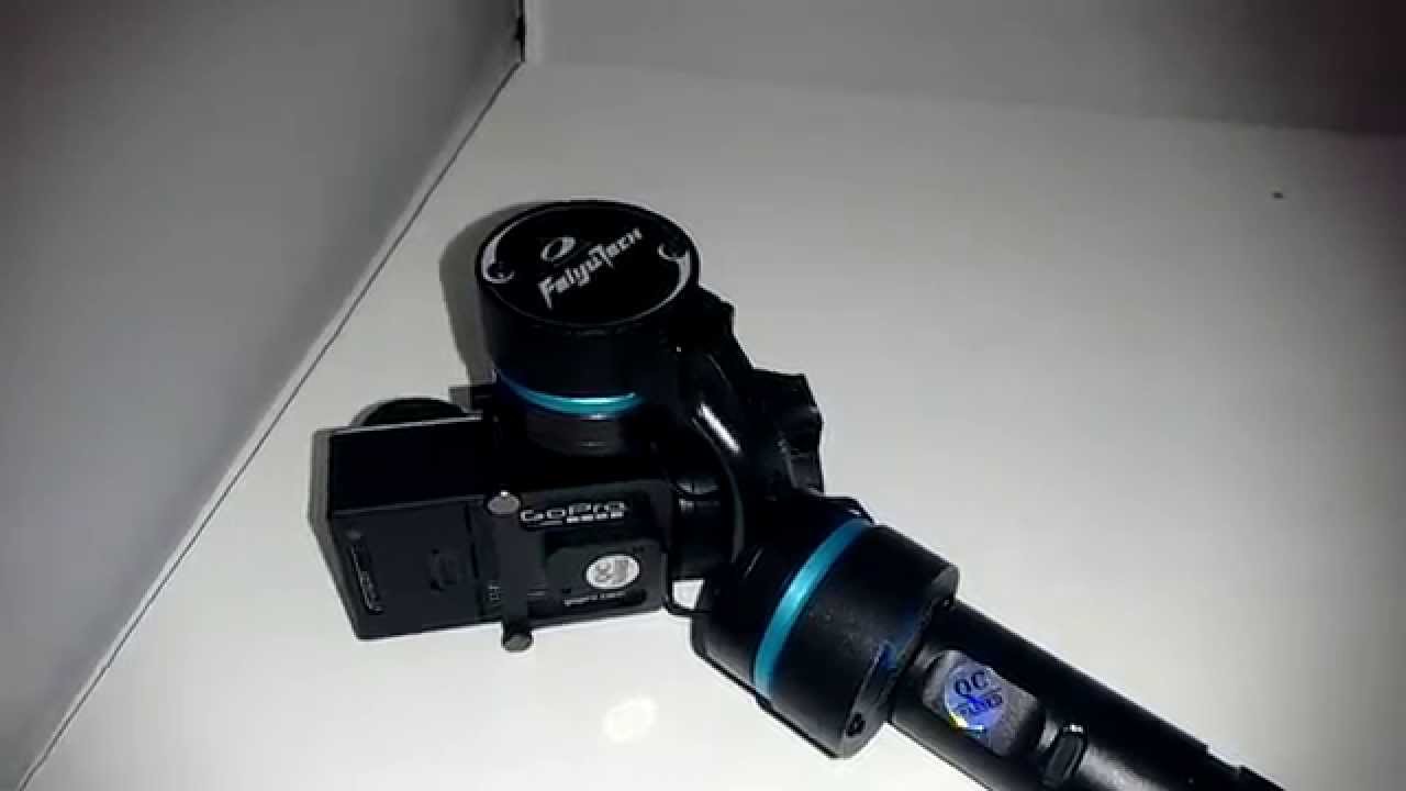

The first step is to ensure that you initialise the gimbal correctly. For the best results when doing this, ensure that the gimbal is as steady as possible. Preferably, you would place it on a table or a solid surface and then turn it on to initialise. When you turn it on, the lights on the motors will flash blue fairly quickly. Once they have flashed purple and the gimbal begins to move to place the camera in the correct place, then the gimbal is initialised. Please see the video below for clarity.
