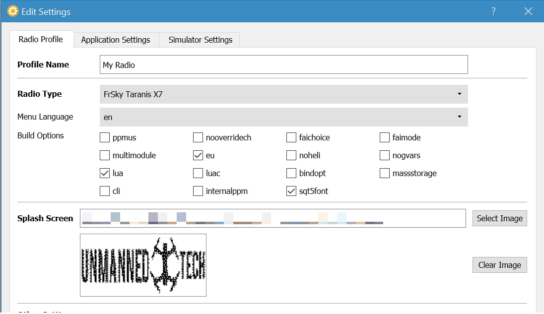

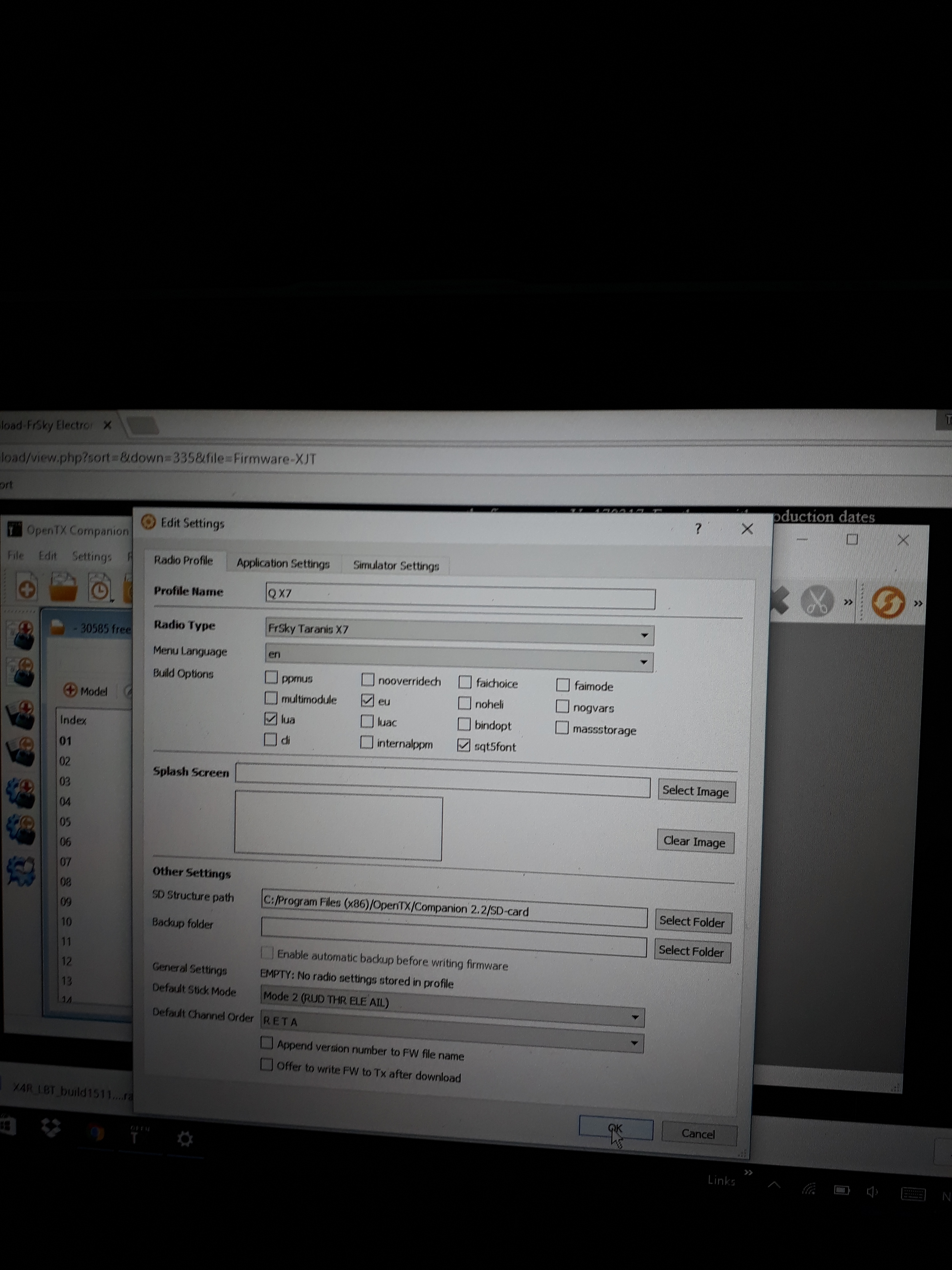

When you flashed openTX firmware, are you sure you selected the EU option?

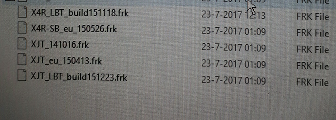

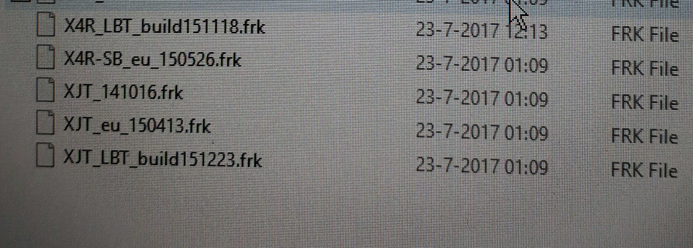

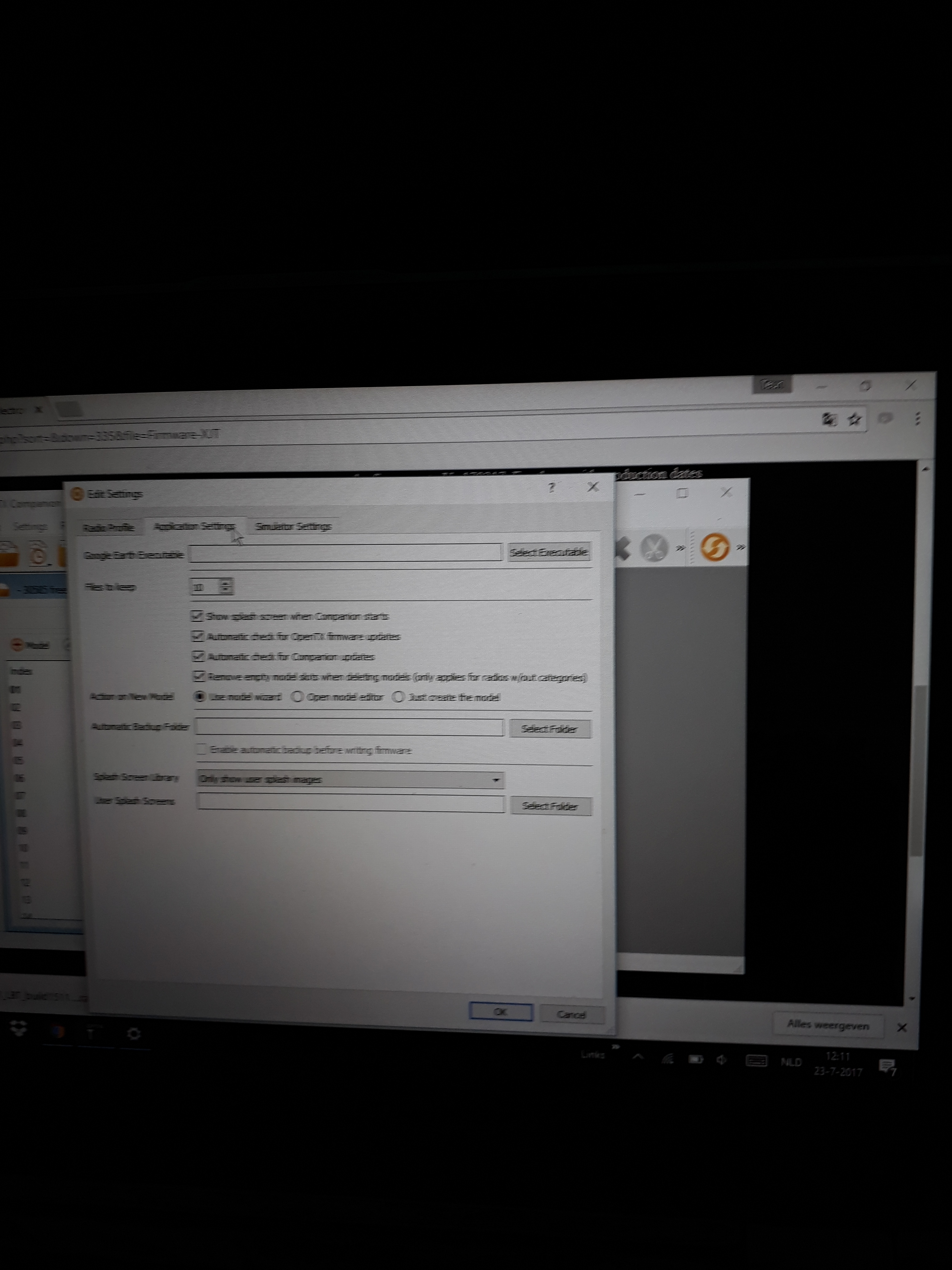

Thank you very much for your answer but I think I did that. Here you can
see my settings profile that I used. You can also see the two firmwares
that I used on my x4r and the internal module. I used the last file in that
folder for my internal module and the first one for my x4r. Both lbt, right?
