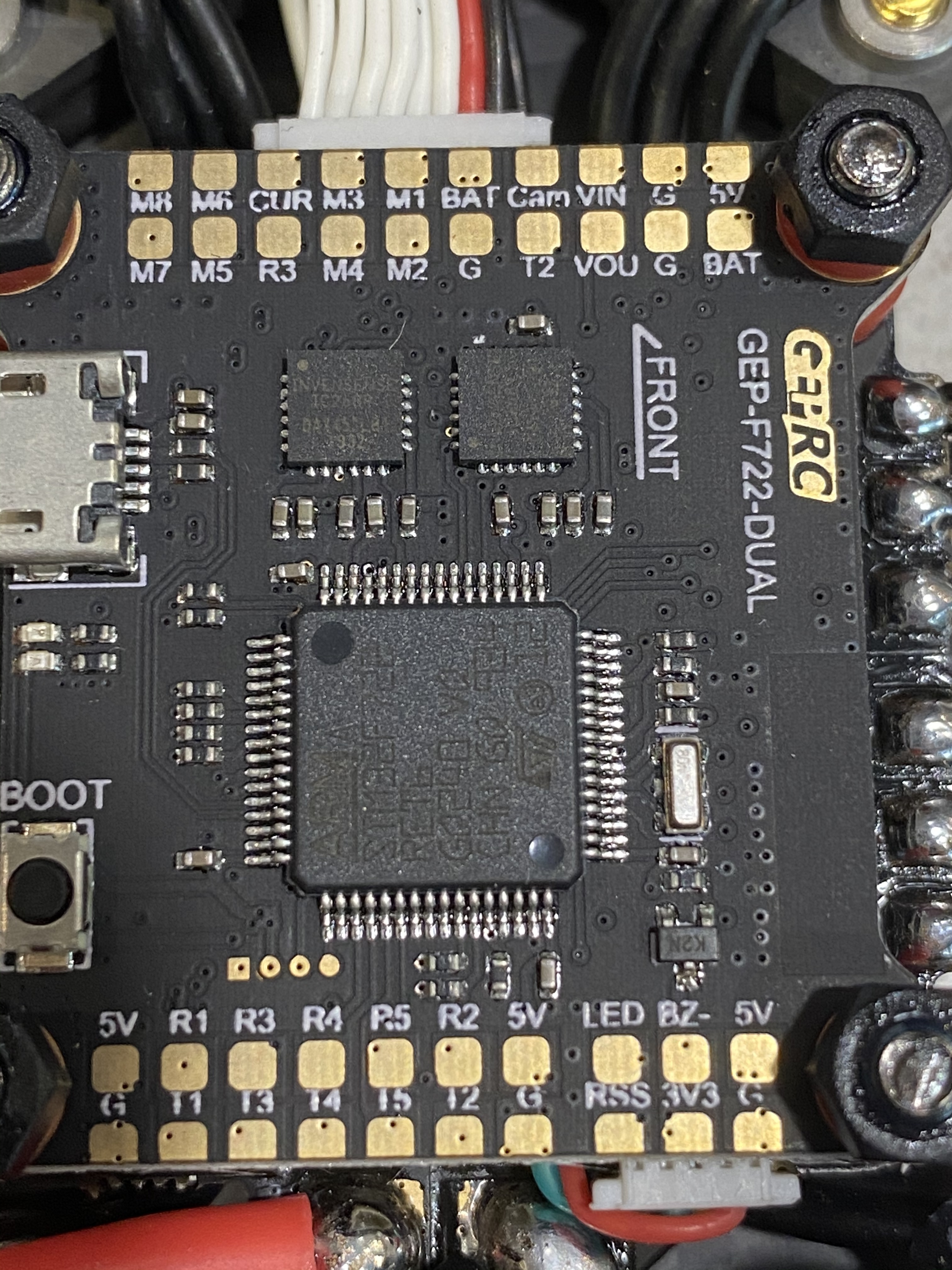

Help support to connect DJI air unit to controller
I just bought a drone and I have to connect the DJI air unit to the controller but I do not know where each cable goes …
Thanks
Hi
With the exception of the power connectors (if using 4s connect to a vbat source) connect the sbus cable to any uart rx pin and the uart rx and rx cables to any other available uart pins.
