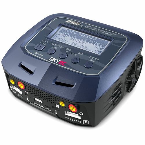

Your going to need a lipo charger to charge it back up.
For ease this charger takes normal AC input to charge your lipo.

Thanks for the big answer bro! I purchased one for 30 quid now I’m waiting for it.
