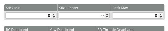

The issue you have with the receiver tab not having any bars, and the bars not moving is something that we have been noticing quite often the last week, so maybe there is some weird betaflight bug that we dont know about yet… But for some reason some flight controllers reset the RC stick min center and max values to zero:
If you set them back to normal which should be 1000, 1500, 2000 you should find the stick inputs will be detected again.

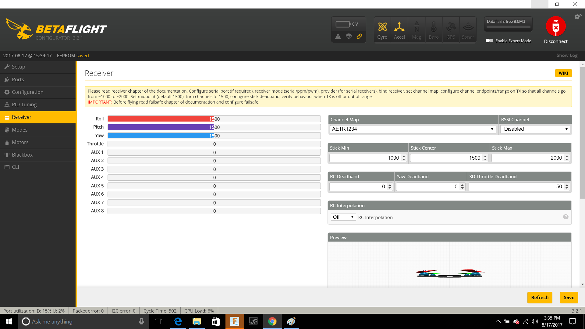

I made the change and it didn’t seem to do much, but it did make a difference.
Here’s the new screen
Two things I’ve noticed that are continuing:
