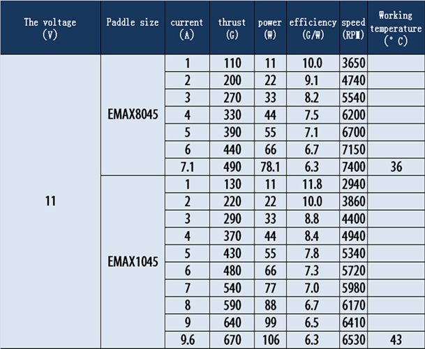

As choosing the battery is often the last step to building your own drone, we will already know what motors and ESC we are using. Since the motors will draw the most amount of energy from your battery we can base our calculation around this.
By looking at the specs of your motors, in particular the thrust data tables you will be able to see what the motors maximum current draw is. As an example, our quadcopter (4 motors) weighs about 2Kg in total (with battery and all other equipment), the quadcopter will hover when each motor products about 500g of thrust. Since we are using the MT2213 motors with 10 inch propellers we can look at the thrust table to see the motors current draw at maximum thrust, which turns out to be just under 10A.
MT2213 Motor Thrust table for a 3S Lipo battery
Since we are using 4 motors, the total current draw will be about 4 x 10A = 40A Other equipment such as your autopilot and FPV gear will all draw a few miliAmps so their effect can be considered negligible, but to be safe lets add another 1A to the total current draw to round it to 41A. So this will be our maximum current draw during hover. So the 5100mah 10C battery we mentioned previously would work just fine since its current output is 51A, however we could get away with using a lower C rating closer to perhaps 8C to have an even lighter battery. However it is uncommon to find batteries with C ratings lower than 10C.
In order to get the most flight time, we could get a battery with a current output of just over 25A. However in reality we will often fly at higher throttle values during a climb, or if there is a strong wind so at various stages in the flight our current draw might be higher than this, which could damage the battery.

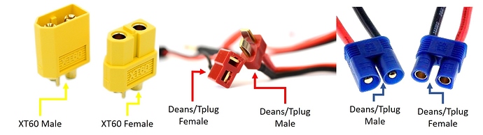

Battery Connectors
Soldering battery connectors can be a real pain, so it is a good idea to try find a battery connector that you like, and stick to it. That allows you to swap batteries easily, and if you decide to build another drone in the future you can use the same batteries. Common connectors include Deans/Tplug, XT60, and also EC3 connectors. For more information on battery connectors and wires check out our connector guide.

Ok so from the example thrust table, I see that the working voltage is 11v. However, I still don’t understands what happens if the voltage from the battery is, say 14v. Can someone please help?
