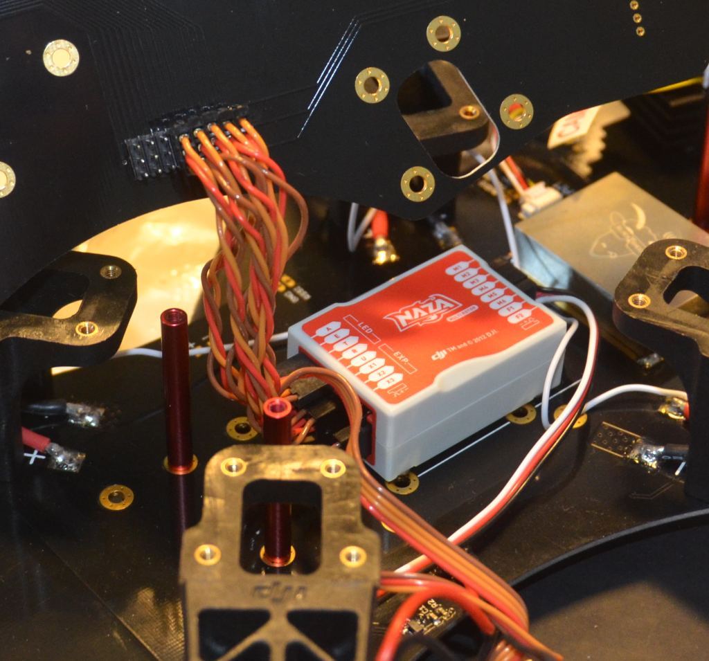

PCM (Pulse Code Modulation) is an old standard and no one uses it anymore so you should use PWM (Pulse Width Modulation). To connect it you should see details in your naza manual, but you need to connect a 3 pin servo cable between your Rx and the naza for each channel. Kind of like in the image below.

Yes it should work just fine with PCM as it does support it. And the Naza M v2 is a great flight controller
