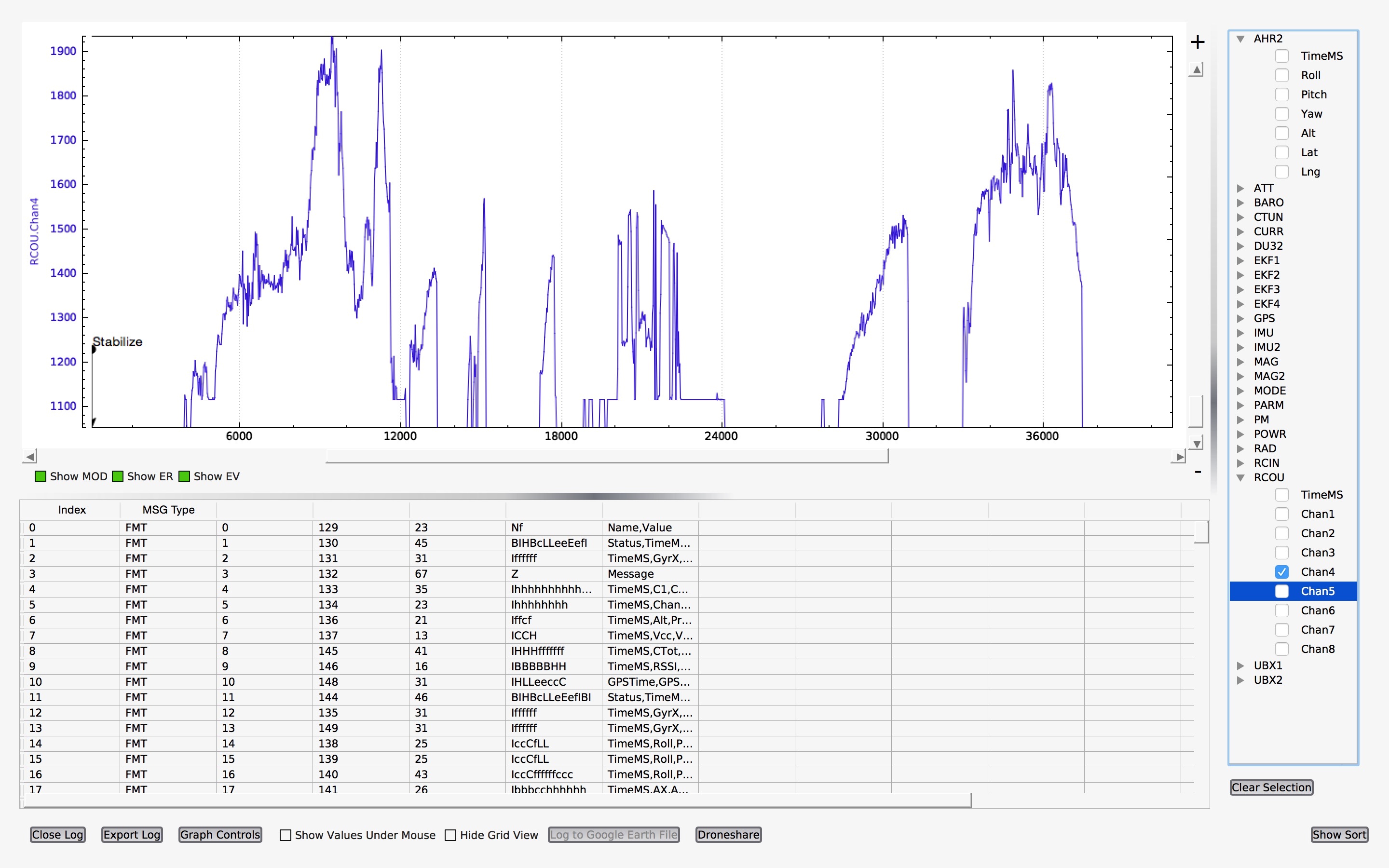

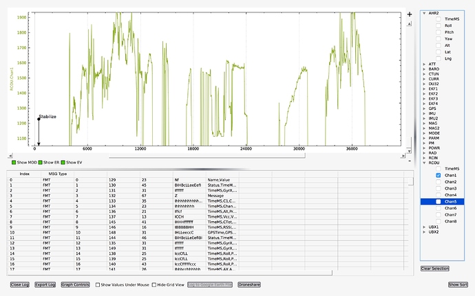

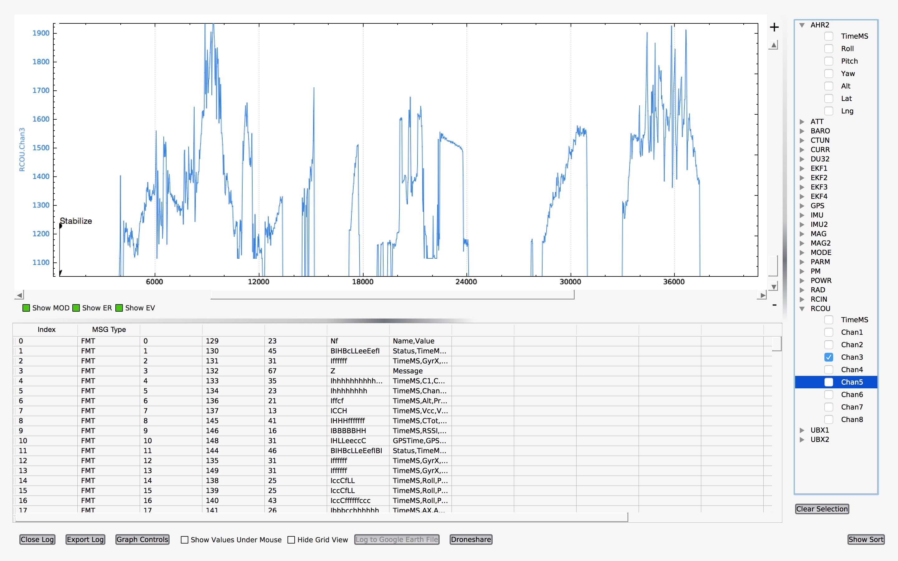

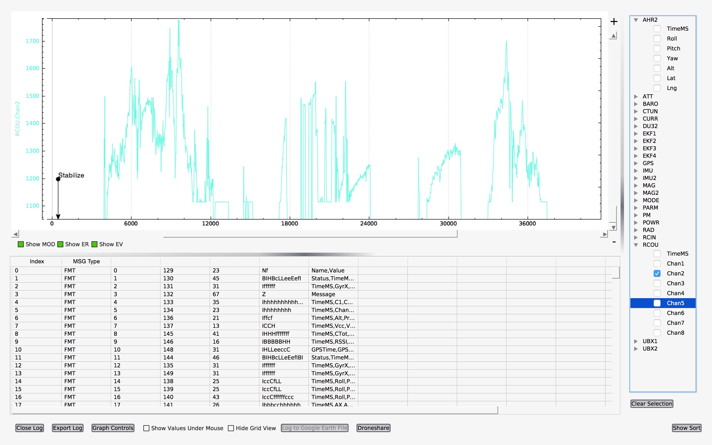

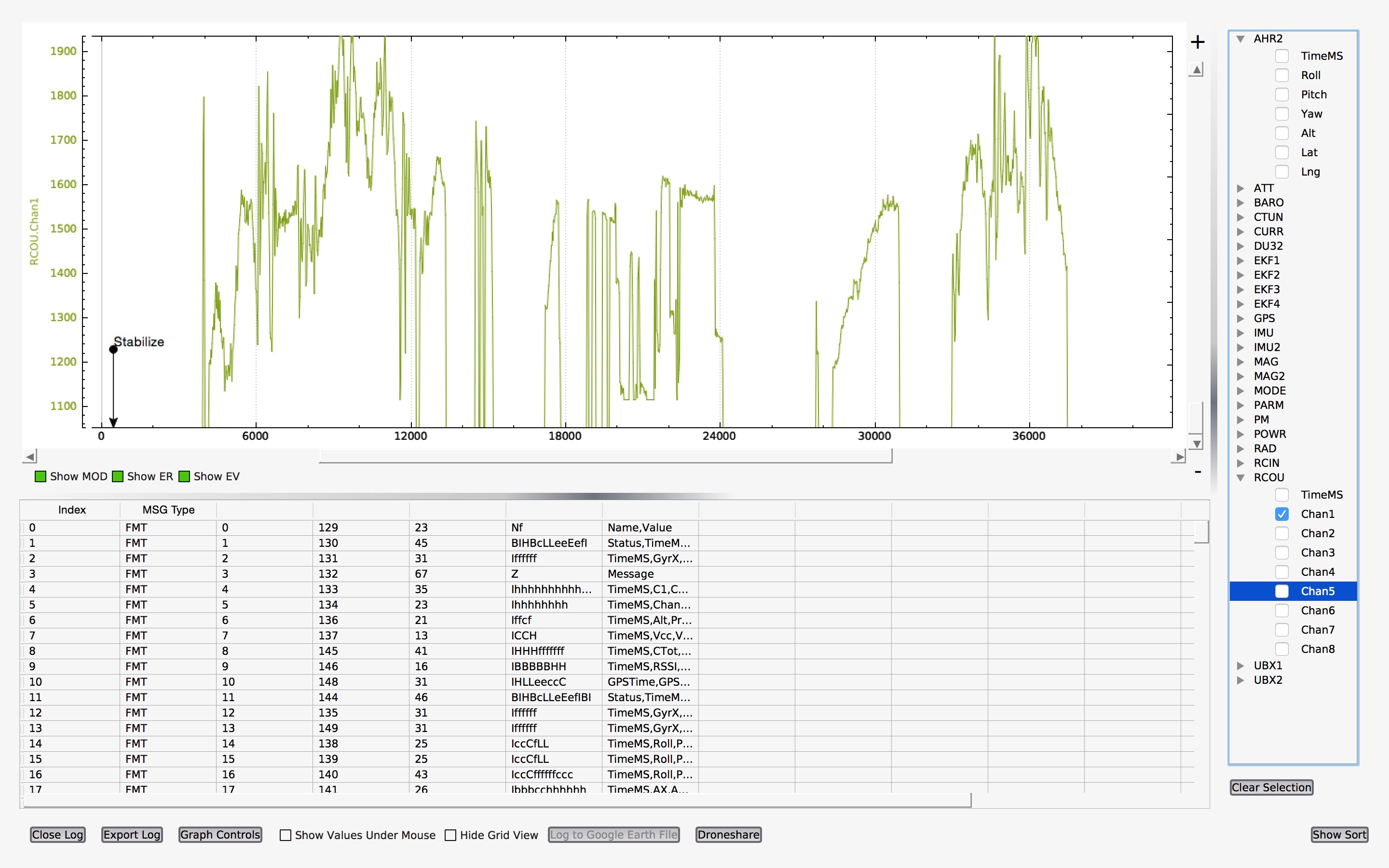

I have removed all but one of the red wires from my esc servo connectors, however I am still encountering the same problems, the motors seems to stutter, it only happens on certain motors, and it happens when they should be speeding up to counter for some roll or elevation, not when they should be slowing down, I will try some different esc settings and post a video. Could the BL Heli software have something to do with this?
And how would I download the log so that some one more experienced can try and decipher a problem?
After you mentioned that your ESC’s have linear BEC I was not sure if that would solve the issue as its the switch mode BEC’s that can cause inteference with one another. You said you are using Afro ESC’s and I know of a buch of people having sync issues with these ESC’s which is what I think the issue is. Are you using SimonK or BLheli firmware on your ESC?
In terms of checking if it is a sync issue you can look at the logs and inspect the RC_out commans send from your pixhawk to the ESC. If the RC out is all over the place then the problem is likely that pixhawk has some sensor issues and is sending strange commands to the motors. Otherwise if the RC_out is smooth according to your throttle inputs then the issue is likely something with the ESC. If you dont know how to look at the logs check out the quick guide on how to analyse Pixhawk log files.

Thanks for the logs, its abit hard to tel from those images. THe best way to test this would be to position your quadcopter level on the ground with the props reversed, or your quad bolted to the ground, and smoothly increase the throttle up and down, and then rapidly increase throttle up and down. If pixhawk is working as it should you should see the same RC_out commands sent to all 4 ESC’s, but the best way to look would be to create a graph of all 4 RCoutputs superimposed on the same graph so its easier to compare.

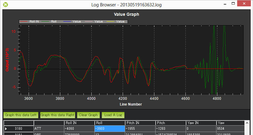

Another thing to check for a problem is to compare the ROLL and ROLL IN values on the ATT lines for the dataflash. In the example below you can see that the aircrafts actual roll follows the desired roll until the end where there was a problem. If you compare these for one of your flights you should see something similar.
