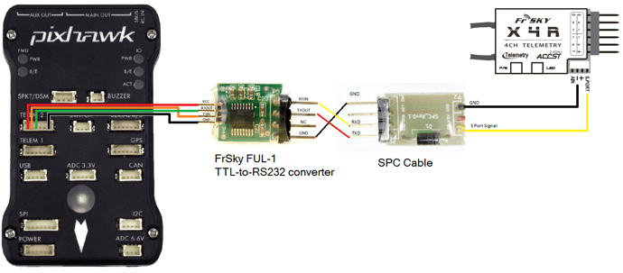

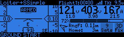

The power module that comes with the Pixhawk, can that be fed back into 8XR receiver (via Pixhawk) for the Taranis X9D+ for gathering LiPo total cell charge battery telemetry?
I am looking for a voltage reader that plugs into the balance lead on the LiPo then feeds the individual cell voltages back into 8XR for telemetry reading on the X9D+.
Many Thanks
Yes it is possible to feed telemetry from your pixhawk back to the ground via the FRsky receivers assuming you are using Arducopter 3.2 or higher. The FUL-1 module is now available from our shop
If using a D-series receiver (like D4R) you just need the FUL-1 module
If using an X-series receiver (like X8R) you will need toe FUL-1 module and an SPC cable
You can read more on how this is possible here

SPC cable and Molex Picoblade 4 position telemetry wire. Do you stock these at all?
