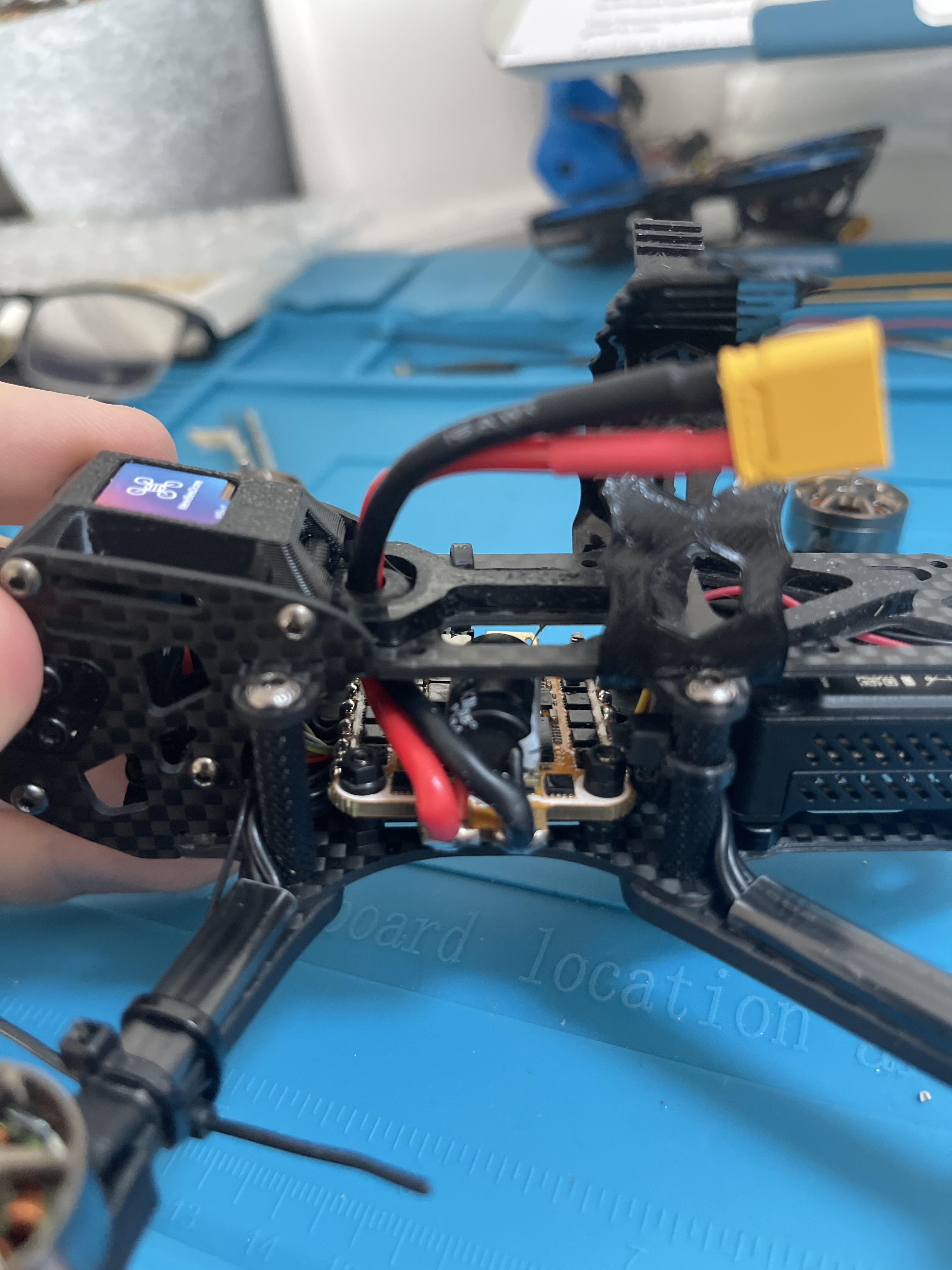

I also had another look at your last log, there does not seem to be any massive issues with vibraitons, but yet the pitch gyro is picking up some motion and its not coming from your radio commands to cause this:
Then when looking at the quad in some more details it looks like maybe the FC is not mounted correctly anymore, as it would seem that one of the grommets are super crushed (on the left), while the other has slipped through a little on the right?
If you could please double check this, and make sure that all the grommets are secure, but not squashed like that, you may find this is the cause of the issue.
Hi thanks for the continued effort,
Sorted out the fc position image attached, since the reflash the black box doesn’t seem to be capturing data anymore, there was some error in some of the cli commands in that file mostly frysky related and others I’m not sure about. So not sure on how to get that going again, awaiting an email regarding return.
